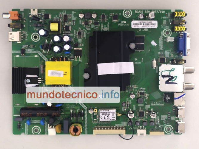

RSAG7.820.6057
Mensajes: 11551
RSAG7.820.6057
Chasis: MTK5652
Modelo: RSAG7.820.6057
MainChip: MEDIATEK MT5652
Micro: MT5652
N56: NAND H27U4G8F2DTR-BC
V801: STK0765BF (CS8N65F)
N801: NCP1251 (5A2RDH)
N17: 1117A (3.30V)
N19: 1117-33 (3.30V)
N25: 1117-33 (3.30V)
N24: GH17P 4396J0
N50: 24C32 EEPROM
N21: TAS5707 (Ampl. Audio)
VD906: MBR10200C
VD816: HER307
VD824: HER307
VD825: HER307
N901: SELC2010M BH1478GR
