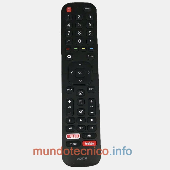

Control Remoto: EN2BC27

[Control Remoto] PHILCO PLD55US9A1
